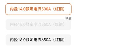

Hi . May be can search this on Alibaba
The internal diameter is 14mm can reach 500A
